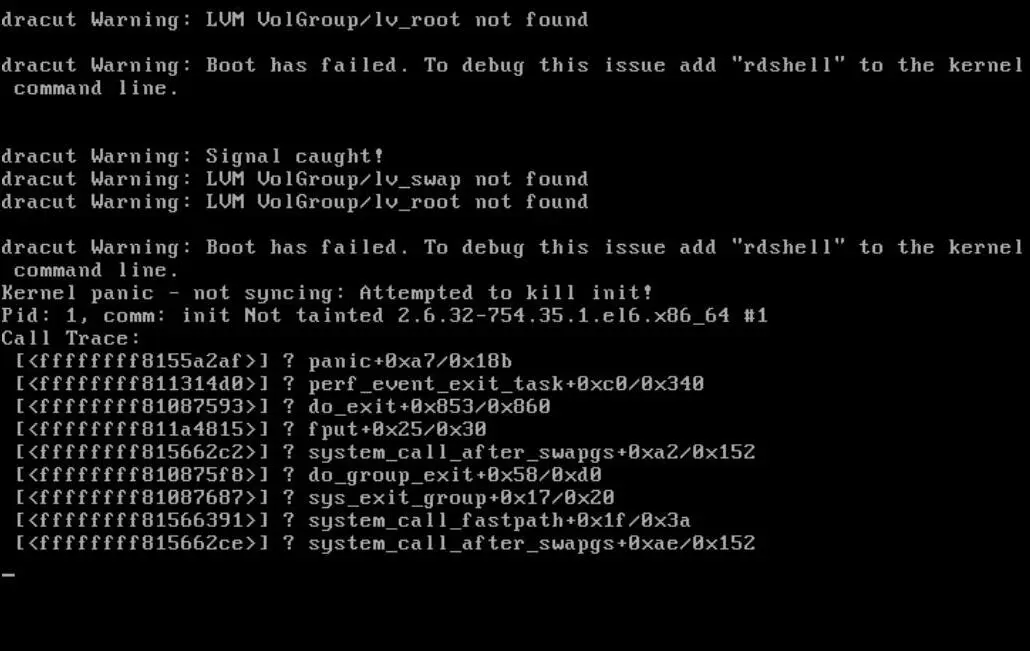

hetzner hz vps现在安装不了centos6系统了?一直找不到硬盘,加载对应的virtio_scsi.ko驱动也没用,kvm宿主机已解决 rdshell lvm
 成长值: 897
签到天数: 5285 天
发表于 2026/2/10 06:07 | 显示全部楼层 |阅读模式 |Google Chrome 144.0.0.0|Windows 10
救援模式研究了好久都没搞定,判定为宿主机虚拟化问题

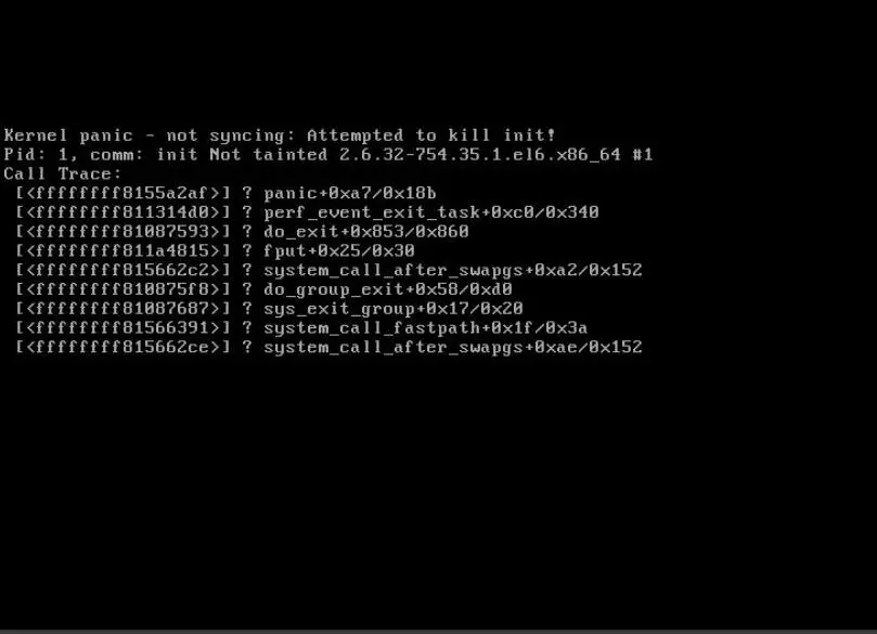

工单客服问一下吧,至少vultr那边,工单一下就能改引导,而且打个快照永久有效不用后续麻烦客服,虽然当时改的不是磁盘控制器依旧没装上centos6,但是理论差不多,无非工作人员改一下虚拟机配置文件的事情
https://bbs.itzmx.com/thread-110781-1-1.html
Request to change Disk Controller type for Legacy CentOS 6 compatibility
I am migrating a legacy CentOS 6.10 (Kernel 2.6.32-754.35.1.el6.x86_64) system to your platform. The system is currently stuck at boot with a "Kernel Panic - not syncing: Attempted to kill init!" error because it cannot find the root LVM device.
I have already performed the following troubleshooting in Rescue Mode:

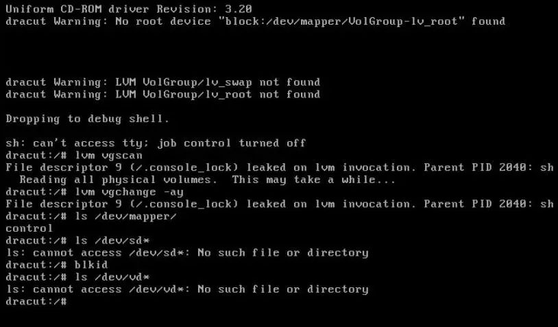

Injected virtio, virtio_pci, and virtio_blk drivers into the initramfs.
Verified that even when manually loading these modules via insmod in the dracut emergency shell, the system still cannot see any disk devices under /dev/sd* or /dev/vd*.
It appears the legacy kernel is incompatible with the default VirtIO-SCSI controller or the modern VirtIO spec used on this host.
Could you please change the Disk Controller type for this instance from VirtIO-SCSI to Standard VirtIO mode?
Server Details:
centos-4gb-nbg1-1
cx23

DD了个centos7发现有一样的问题但是能解决,hetzner vps走的都是scsi,救援模式下fdisk -l /dev/sda看到Disk model: QEMU HARDDISK,已自带有sd_mod驱动,但是缺少virtio,dracut加一个就好了,centos6就无解了

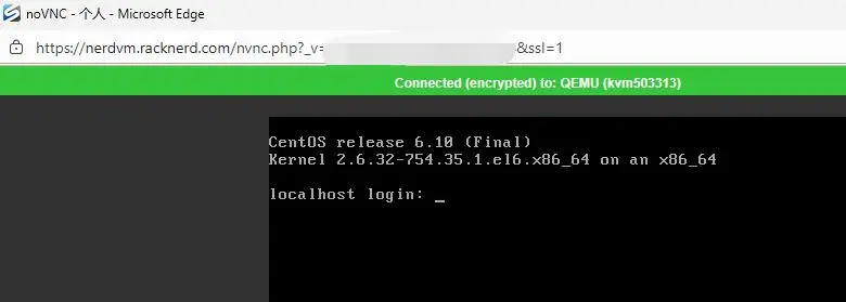

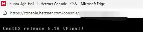

centos6启动找不到硬盘总算是解决了,就是在centos6救援模式下chroot进入磁盘后运行
  1. wget http://github.itzmx.com/1265578519/kernel/master/elrepo/kernel-lt-4.4.246-1.el6.elrepo.x86_64.rpm -O kernel-lt-4.4.246-1.el6.elrepo.x86_64.rpm
  2. rpm -ivh kernel-lt-4.4.246-1.el6.elrepo.x86_64.rpm --force
复制代码
由于elrepo提供的内核默认是不会改引导启动的,需要自己改一下,改成default=0,代表引导最新安装的内核
  1. vi /boot/grub/grub.conf
复制代码
最终效果图
无需管dracut,系统直接就能登录使用了,唯一的遗憾就是基于驱动层的tcp加速用不了啦,因为Linux内核版本发生了改变,tcp加速仅支持2.6.32内核,反正服务器要套cloudflare,网络传输速度已经不重要了
在hetzner能跑就行,或者选择其它服务商就没这个找不到硬盘的毛病了,也不知道以后会不会有其它的kvm宿主机的服务商升级虚拟化底层,然后工单也不管用户,那就只能换内核了,在加上elrepo也停更了,4.4内核就是极限了

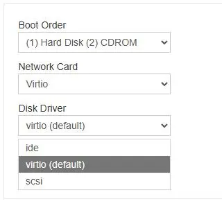

还是其它服务商好,默认virtio而不是hz那种scsi,默认virtio兼容性是完美的直接启动成功,而且用户还可以自己选择模式,根本不需要工单联系
